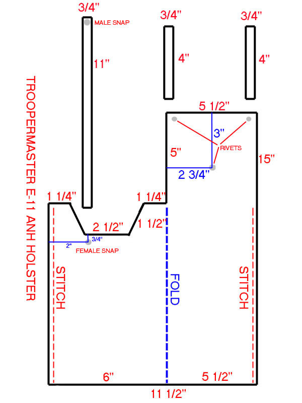

Maybe this is somewhere else...but is there a patteren out there for a blaster holster(E-11)?? I want to make one for my snowtrooper and possibly replace one of the pouches with it... any thoughts/ideas??

like this?

huh....well I guess I'll try this...at least till something better comes along....lol Thanks looks like what I need! :thumbs:
P.S. Is the bottom stitched also or is it left open?

jabba974 wrote:Is the bottom stitched also or is it left open?
It's left open. :thumbs:

Ok..tried it with that pattern, but i didnt like how "flimsy" it was with the cloth material I was useing....I think if I was using leather or vinyl, it would have been better... But with a few adjustments this is what I came up with....
I still have a pew more things to do, but what do you guys think?

Jabba, you could always sew cloth around thin leather or plastic so it holds its shape while still have the look u need
