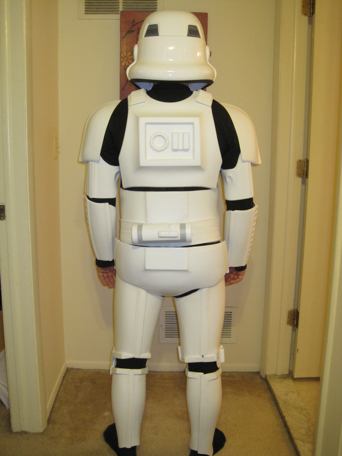

Hello to all my future 501st members. My name is Sean Belcher and I have been bustin my tail to get my armor trimmed, sized and strapped. Its my first TK build and have been obsessing over it for the last month and a half. I am about 90% finished and can't wait for a decision on becoming a member of something I have dreamed about forever. I have a TE(2) set and am going for ANH stunt. I also have been playing drums since I was 9 and am currently in a band named "Cold Conspiracy." we are based out of Monroe and if anyone is interested in hearing some of our music, it free to download at myspace or facebook. We are opening for "Taproot" this Sunday at Headliners in Toledo so If anyone is interested come on down. You will know me by my TK sticker on my kick drum. I have some pics of myself in armor I would like to post and if anyone would take the time to critique please feel free to do so. I'm still in the process of painting and am waiting for my holster and boots. The bucket I'm wearing is an EFX ESB. My ANH stunt bucket is almost finished. Thank you for reading and I'm sorry for rambling on. I think it is so cool that this is out there. Can not wait to meet most or all of you.
- storm sean 006.jpg (405.58 KiB) Viewed 28445 times

One thing that jumps out at me (and it could be the angle of the entire thigh piece, or the fit on your leg) is the Ammo Pack on your Right Thigh. It looks to be a bit off center.
Post up some more pics (include some from the side and back). In your ANH bucket, are you putting in fans an such for cooling?

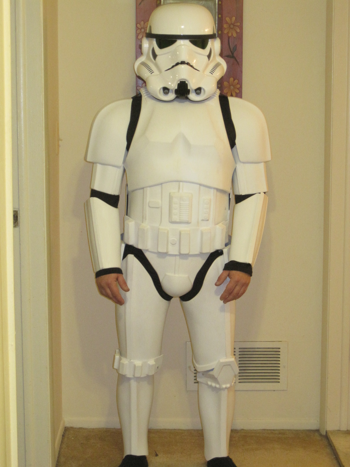

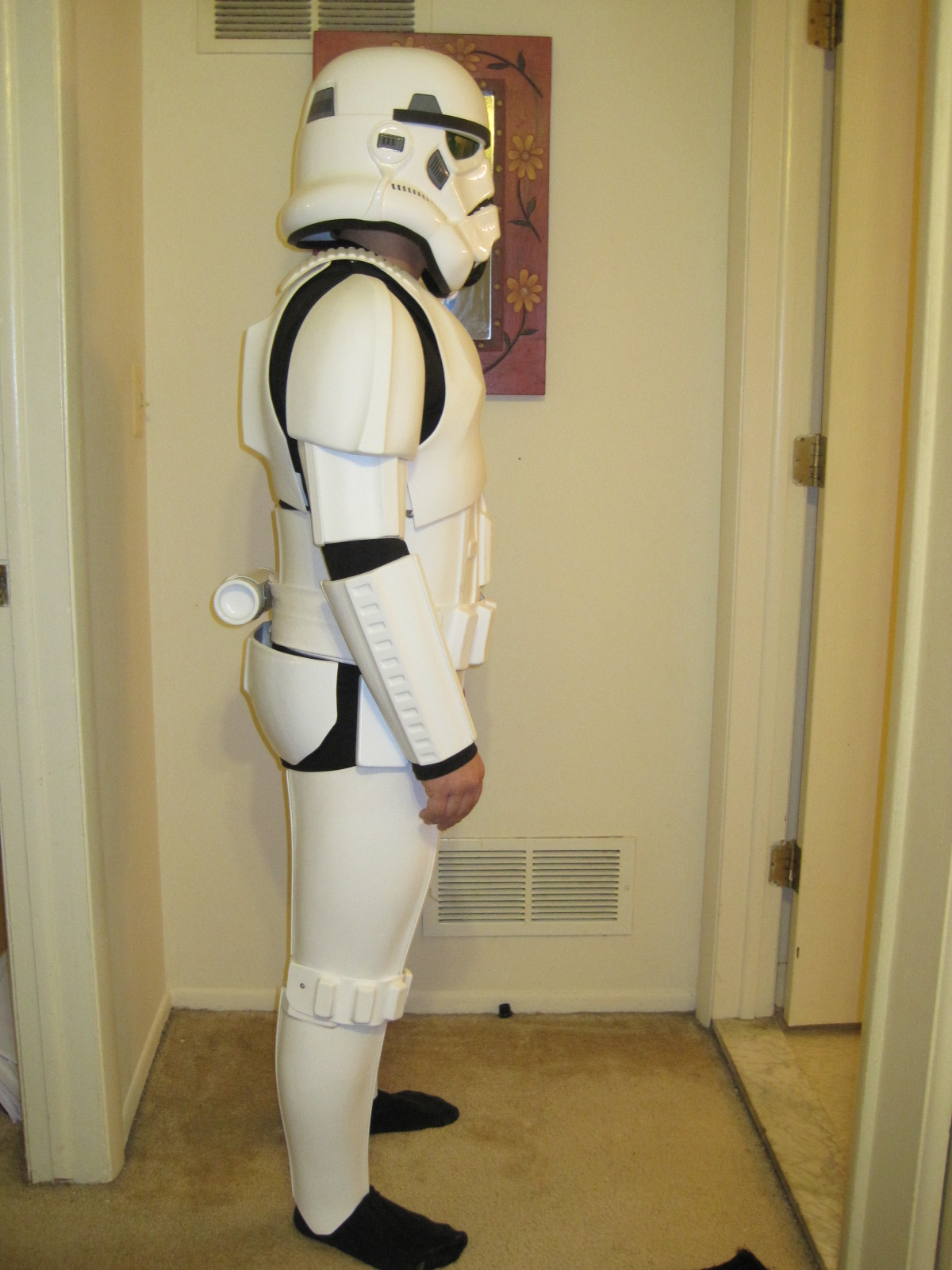

Thank you so much Rob and Jerry for the welcome. I am noticing the battery pack and how it looks like it is off center. I will look to see what I can do to fix it. I'll post some more pics for you to look at and please let me know if you see anything more I could do to improve. In one pic I had my girlfriend attach my o2 canister and it is off center. I also notice that my butt plate is sagging (LOL) a little. I think that should be an easy fix.
- storm sean 007.jpg (398.76 KiB) Viewed 28404 times
- storm sean 008.jpg (405.89 KiB) Viewed 28402 times

Everything looks good other that the knee being off center as Jerry said. Take caution when removing the rivets to adjust it because when you drill them out it will melt the plastic if you heat up to much. Drill slowly and stop once in a while. As far as the butt plate goes. It looks fine to me. Eveyones is a little different but some of the guys that have been here a while may have some tips on how to improve it.

Coupla' things I noticed since I have a Sandie and also used to have a TK myself.
I'm Rome, the Webmaster & main forum admin here, as well as a Sandtrooper & Imperial Officer. I moved the thread over here to the costuming section since we've pretty much just launched right away into a costume review and recommendations session (which ain't a bad thing!).
- Painting the inside of the helmet black will help in reducing any glare and reflected light that may be visible through your lenses, as well as drawing less attention to the exposed parts of your face, like your jawline there.
- The butt plate can be tightened up by warming it up a bit and making the curve more acute. Also, some additional strapping on the right and left edges to connect it up to the kidney plate can help with that sagging. Although you can see the gaps in the armor of the movie screen shot that forms the background wallpaper of the forum here, you can see that the sides of the butt plate are actually pretty form-fitted to the person in the armor and doesn't flare outward.
- Don't worry too much about items being off-center. As long as they're centered for your membership submission photo, you should be all clear. When we put on and take off the armor and parts for events, it'll look a bit different each time.
- You're going to want to trim about an inch or so off of the bottom of the shin pieces. Once you get your boots, you may find it more difficult to flex your feet in order to walk. Parades are murder if you can't walk comfortably!
- Looking at the behind photo, yeah, your right thigh detail piece is off-center. If it's reasonable to drill out the rivets and reattach that piece aligned a little more to the left, it might be a good idea. The rivet hole that's left in the thigh piece can be filled in with some Bondo, sanded, primed, and then when the armor pieces are painted, it'll look like it never happened!

Rome, thank you as you nailed all the questions I had as far as mods concerning the extra trimming along the bottom shins and the back of thigh. You also nailed my height (5'6"). I fixed the right knee battery pack and added a extra strap to the middle of the ab and butt. It looks a lot better but after you told me about heating and forming I may have to do that. I recently finished my bucket and the first thing I thought of was painting the inside black and strengthening. Can you suggest something that I can use? I will post more pics for you to look at and suggest mods. I was reading about cutting an inch off the top of thigh and adding a return edge but I don't feel confident about doing the return edge. I would love to see Andys kit. I used to have a nice TAMA Starclassic that was pretty big but sold it and downsized. pain in the butt for playing shows, setting up, breaking down and transporting. Thank you for the help dude. It's much appreciated.
