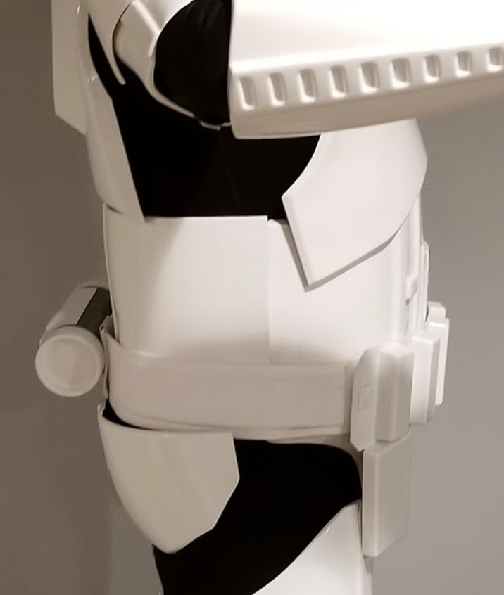

I am ready to get my torso pieces fit and assembled. Here are some pictures of pieces on me. I am looking for the following:
1. Is the top of the ab plate supposed to align to top of the kidney plate?
2. I have seen some build videos where the back plate ends at the top of the kidney plate. Is this the case? If so, what do I need to do?
3. Item 2 kind of plays into next question, that the kidney plate looks tall? Is it sitting at correct height?
4. Where should the top of the butt plate rest with respect to my body? the bottom of my back? where top of typical pair of pants sit? It looks like it slipped down a little during picture taking in a couple shots.
5. Do i need to reshape the O II back plate? it seems to curve in at 45 degrees when it wraps around to front of body at bottom?
6. I feel like the front breast plate is obtuse or flat. Should I shape it to be more form fitting? Or should I wait to do any shaping until after I have it together.

1. Yeah, more or less. When doing fitting you're going to want to tape those together on the side for the correct fitting.
2. Usually it kind of sits on top but overlaps in the corners in some cases. I've never seen a back plate that's shaped like yours, though. So it's difficult to make any recommendation.
3. Kidney plate height should be fine.
4. Typically your butt plate is going to end up floating above and "around" the kidney plate. This will get covered by your belt. Just make sure crotch lines up and don't worry about making sure the butt "locks in" perfectly with the kidney.
Do you have a build thread going at whitearmor.net? You'll be able to get damn near real-time advice and critique from the best of the best there, as well as follow others who have built the same kit as you.
EDIT: My bad, I just saw your previous post. Not sure why you're not getting a response. You could always switch to working on another part while you wait for someone to comment.

I dug up a photo from when I was at the same point as you. Here's the side view of what my armor looked like before cutting an angle on the butt plate, and putting everything together for approval.
I'm not familiar with FX but it seems kind of oddly shaped. You may be able to get creative and slice it up to look a little closer to this, however.

Are you stating that you do not have the butt plate vertical that you rotated it and then cut it at an angle to square it up with the ab plate in the new position? Fitting this is sometime difficult by yourself. I will go back to forums for screenshots of butt plate to see if I can make mine fit better.The Snake wrote:I dug up a photo from when I was at the same point as you. Here's the side view of what my armor looked like before cutting an angle on the butt plate, and putting everything together for approval.

No, I mean I just cut a notch in the corner in it. I should have shown you one of these shots instead. The attached photo is from my approval photoshoot. If you can get your stuff looking like this, you should have no issue getting approvedmjrose927 wrote:Are you stating that you do not have the butt plate vertical that you rotated it and then cut it at an angle to square it up with the ab plate in the new position? Fitting this is sometime difficult by yourself. I will go back to forums for screenshots of butt plate to see if I can make mine fit better.The Snake wrote:I dug up a photo from when I was at the same point as you. Here's the side view of what my armor looked like before cutting an angle on the butt plate, and putting everything together for approval.

Thanks for the additional clarification. It looks like my FX kit already has that corner removed. I appreciate the input from everyone.
PLEASE, if anyone is having any building parties or if anyone is planning a working day on theirs in the Metro-Detroit area, let me know. It would be nice to talk through things with others.

Ok. I’m back in basement today. Should have shin pieces assembled by end of weekend. I’ll add pics of progress later when log into computer. Posting from phone now. I definitely like the cover strip method over the FX over lap method. Cover strips only FX are Loki g good on my FX kit. I’m glad I took time to go this route. Thanks to trooperbay more abs is showing up By Tuesday so I can get thighs done with cover strips as well. I got a lead on belt I want. I just need to figure out fit for torso. I’m trying to find an extra set of hands and eyes to help.

I want to give a special shout out to Al Tong who gave up part of his Sunday afternoon to help me with some sizing and plethora of questions. Here is a link to whitearmor.net where I have posted my latest updates and questions....
