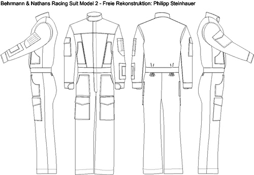

The flight suit. As is, it would not be approvable. The zippered arm pocket and zippered chest pockets are incorrect, the collar is incorrect. It looks like the chest/hip/thigh pockets are all absent also. I've attached a diagram of the pocket layout below. It *may* be possible to modify this suit, but depending on your ability/access to a sewing machine and finding an exact match to the existing suit material, you may be further ahead to buy a new flight suit from a vetted vendor, or scratch build a new one (mine is made from two pairs of RedKap (similar to Dickies) coveralls. I used one pair to cut up for pockets so the material would match.
